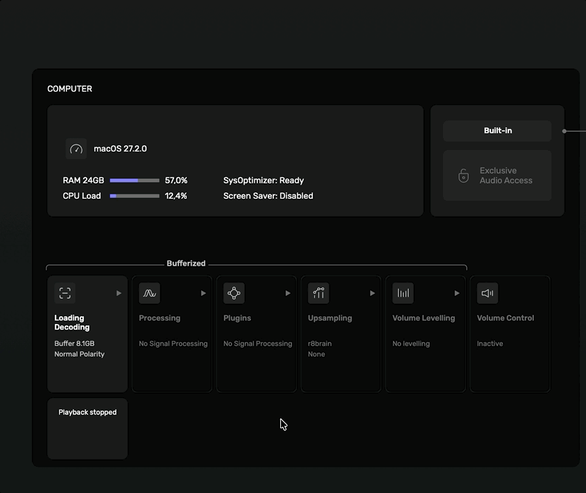

Step 1: Open Audirvāna audio settings
Click on the settings button at the top right of Audirvāna to open the settings:
You can also access the audio settings of Audirvāna if you click on the speaker iconat the bottom right of Audirvāna:
Note: you cannot change the audio settings while playback is active, even if paused. Click on the lock icon to unlock the access to the audio output.
Step 2: Open Upsampling settings
You then need to click the steering wheel in the upsampling section and then select the setting you want to enable upsampling:
Please read this article to know more about each upsampling setting you can set.
